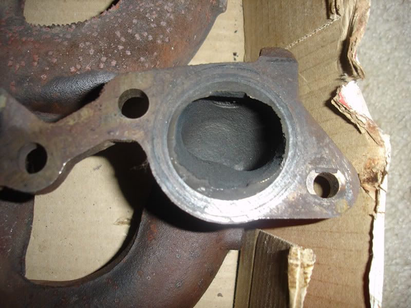

I'm not planning on doing headers in the forseeable future, I don't have the $$$ for SLP's or used TOG's, and I don't want to do SpeedDaddy's or SSAC's. I do however, have a front manifold here (off of Jovan's car), as well as both MIG and Arc welders, along with a giant air compressor and a decent die-grinder. I plan on porting this manifold, sandblasting it, ceramic-coating it and installing it, to go with my DP, the added flow and not have to skew my injectors, etc. What needs to be done?? Pics would be great, along with the bits I'll want for it and a detailed description.

If you plan to port a front manifold, you have to build up the material first on the 'neck' of each runner where the restriction is, then grind it out to match the flow of the rear. If you do that right, no skew is necessary. That's just for an overly large Plog (that wasn't designed correctly).
You have to ARC weld it with NICKEL rod. If this is your plan, you better let me know now before I ship, so I can throw some nickel rod in the box for you unless you just go buy it yourself. Cast iron must always be welded with nickel rod.

If anyone has any pictures of a welded then ported front manifold I'd appreciate it.

Nothing more than anyone else has done. Provided there aren't any issues, I don't for-see more than 2 days on it.
PostPosted: Wed Nov 02, 2011 10:47 pm
PostPosted: Wed Nov 02, 2011 10:55 pm
OOohhh, THAT makes sense now. I thought I had to go down inside. Now it's crystal clear. Thanks for the pics Andrew.

No porting on the rear. You're matching the front to what the rear is (front is restricted in comparison).
Just a standard carbide burr for a die grinder.

Do it. Clean up any burrs or roughness to match the front, but don't PORT. And you want ceramic on that one for sure. It's easier to remove with the blower and LIM off (access to studs) and remove it through the bottom, easier than headers.
