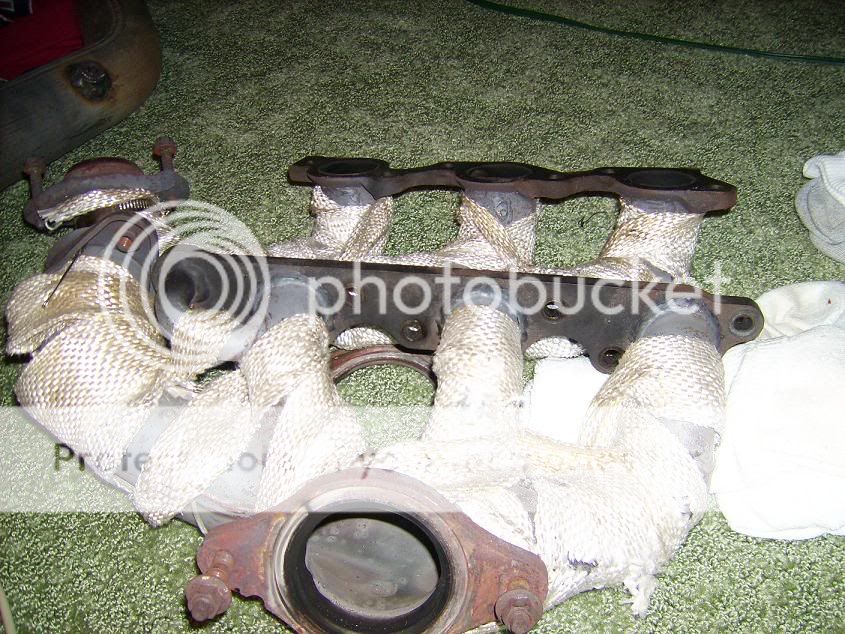

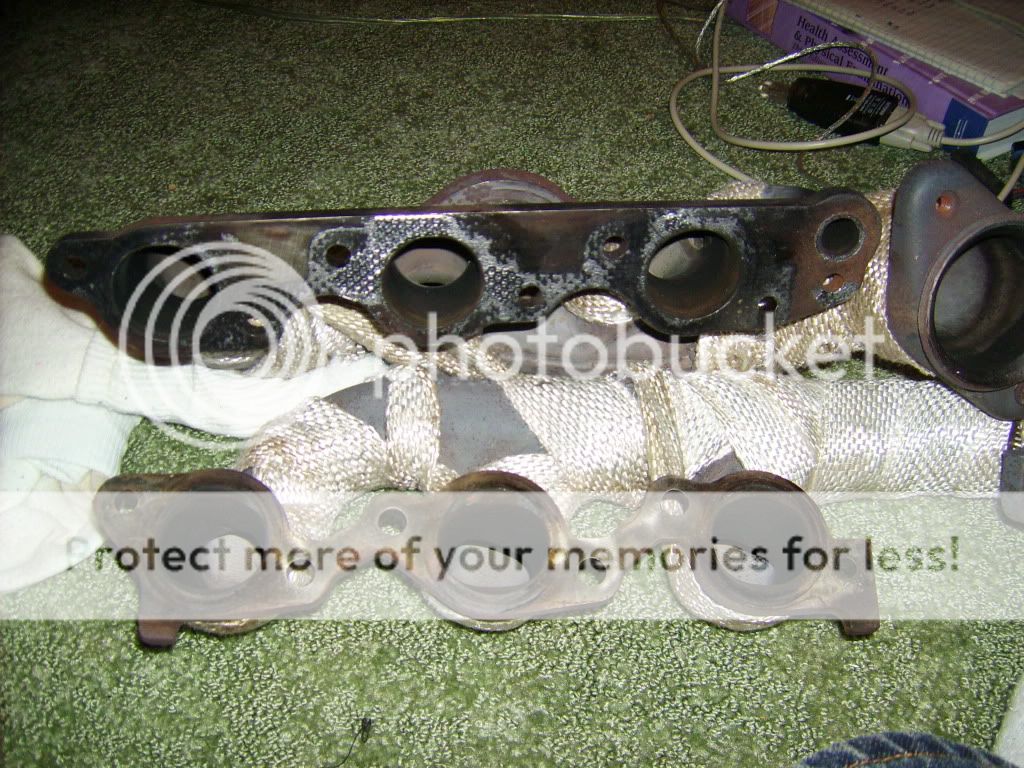

If anyone has any pictures of a welded then ported front manifold I'd appreciate it.
k brah.
Skip the front ported mani, ask me. Keep the primaries D shaped, not O shaped. Nickel on the backside, but then again just wasting your time.
If anyone has any better ideas for what I can/should do, etc, I'd be happy to hear it.
Use the $ for stock mod'd rockers, than yt. Its proven. Take dead weight out.

The D shape port is important for the cylinder head, not the manifolds. The manifolds being D-shaped actually negate some of the benefit of the D-shaped exhaust port on the head. The idea is the return wave coming back against the gas flow is partially dissipated by the D shaped head port. If the manifold is also d-shaped, it allows that wave to re-enter the head and combustion chamber, which hurts performance.
This is why the rear manifold isn't D-shaped, nor is any set of headers. The front is D-shaped to simplify the casting/fit. This makes it a poor design for performance, especially when you take into account that it's restricted when compared to the flow of the rear manifold. This is even worse because of the distance the gasses have to travel to the downpipe compared to the rear flow distance.

The collector is more restrictive than the primaries. You want the D shape so flow faster on the upper edge to force air threw collector.
