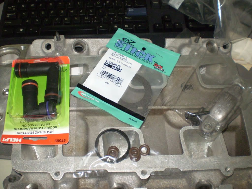

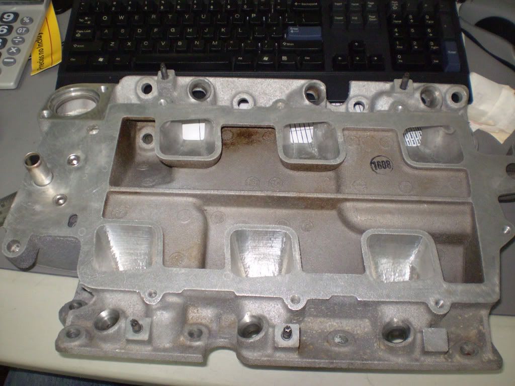

First of all, thanks to Agrazela for a great looking LIM :hail:
This is it.
& all the parts.
Now my question is: other than the seals, do I need anything else? & what are the best seals I can get?
part # & where to get them.
I dont want to start dismateling my engine & then find out that I need something that I have to wait a week to get.
so any help will be apreciated.

Bet you don't have a gasket for the endplate. Those are typically not removed when I do a manifold, unless I have a gasket for it already. Those can be difficult to come by without buying a whole top-end kit.

cant I use the one thats on the car right now?

No, the gasket isn't reuasable. This is something you have to take into account when porting a LIM or porting one for someone else. I always ASK the 'portee' if they have that gasket before I remove that during LIM porting.

do you have a picture of the gasket? to know what we are talking about.

He's talking about the gasket in the bag with the cap and the two bolts (on the right in the pic). Unless I forgot to include it :sad:
ZZP sells 'em for like $1 apiece now. :wink:
If I forgot it, I'll mail you one.

No I have it. I just didnt know what Will was talking about. Now I know what the end plate is. :roll:
& thanks again, it looks beautifull. Now Im tinking that while Im at it might as well add some rokers & send the PCM back to INTENSE for retuning.
