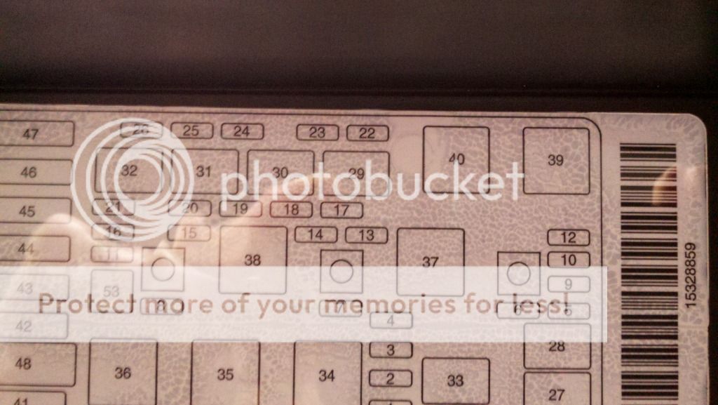

Looking at the fuse block diagrams, it shows "Cigar" as a large 40amp fuse in the rear fuse block #65. Then "Aux APwr" #22, and "C/Ltr" #23 in the under hood fuse block.
PostPosted: Mon Nov 19, 2012 9:47 pm
Picture is as you are standing in front of the car. The extra slots are to position the fuse so the circuits are always on or only on with RAP.

Thanks alot guys, I found the fuse, replaced the fuse and I can use the lighter in the front to charge my phone again. Pizza for everyone, my treat!
