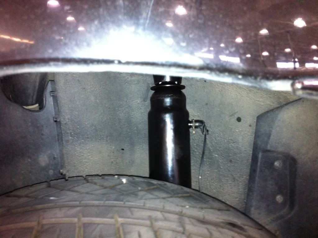

Just moving around the parking lot it already feel much firmer. i cant wait to get it out and drive it. might have to do the fronts now, if the rears are as firm as they feel initally the 145K mile fronts are need of attention.
KYB SR1002 installed:

definatly feels a bit more crisp. The KYB's are definatly much firmer then the stock (leaking) shocks. If your looking for a firmer feel, they kyb's definatly do the trick. id imagine the Monroe Air max shocks will be a bit softer, i think thoes are the ones i did no my moms Lesabre back a few years ago. These definatly give it that "PONTIAC" driving excitment feel they advertised when it was new lol. If your looking for the smooth buick ride, don't think these are the shocks for you. Hope this helps someones decission at some point.
