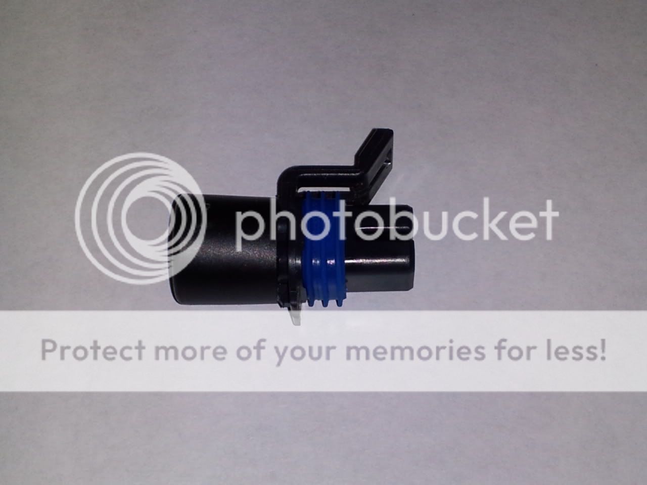

I had a CEL fix on my WRX because i added a Cat-less downpipe and worked like a charm, i don't know how it works on other cars but it worked well for my subie. I would say look on ClubGP and see if there is someone locally to you that has Powrtuner and have them disable the code. My CEL fix on my subie looked like this (pulls the O2 sensor out of the exhaust stream.
