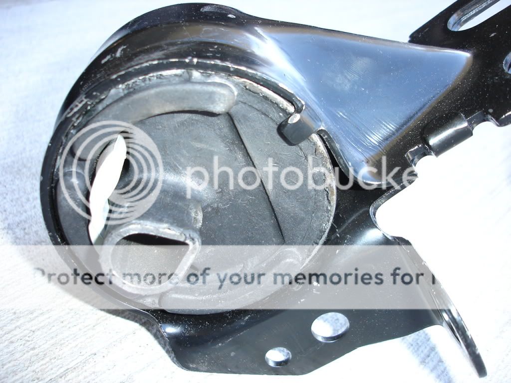

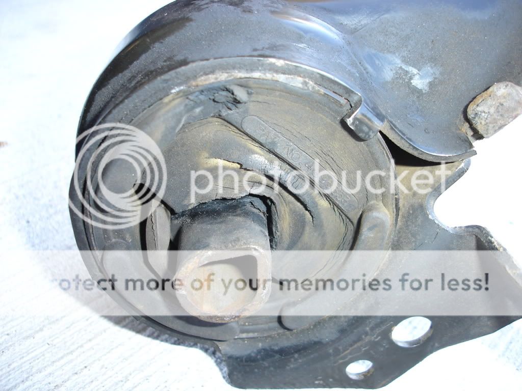

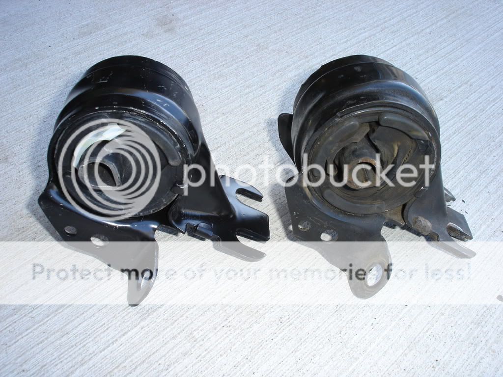

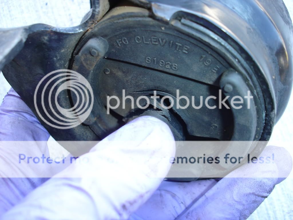

Sorry I didn't see this sooner.
The grinding the passenger floorboards is the TAM (torque axis mount), I 100% guarantee it.
I had it my 95, and also the 97 I sold to my dad.
viewtopic.php?f=9&t=9679&hilit=tam&start=140
harofreak00 wrote:
Replaced the TAM today. The grinding is completely gone.

Well it causes the metal on metal transfer on the passenger side of the frame, but it can transfer then to the entire car.
You will have success in replacing the TAM.
