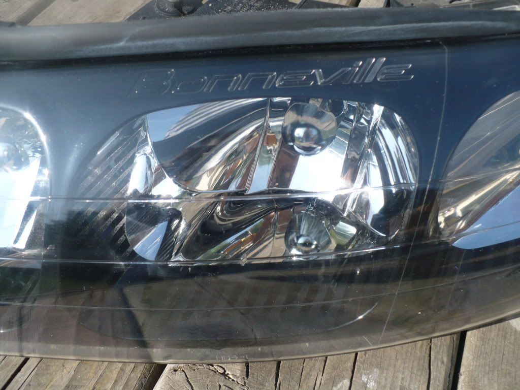

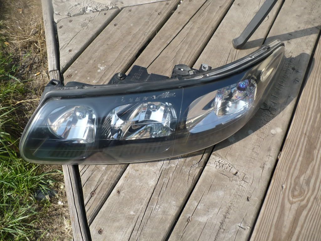

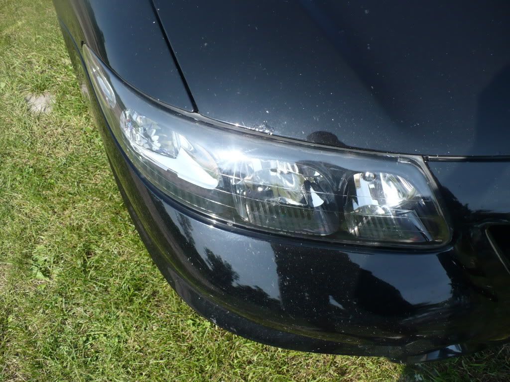

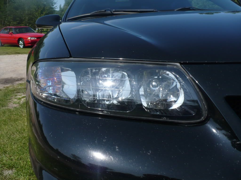

Washed up both cars today and decided to fix the other headlight on the '03. I wet sanded and polished the passenger side during the Michigan meet, but didn't have time to do the drivers side. Had time to do it today and take some pics, here we go.
Passenger side already done

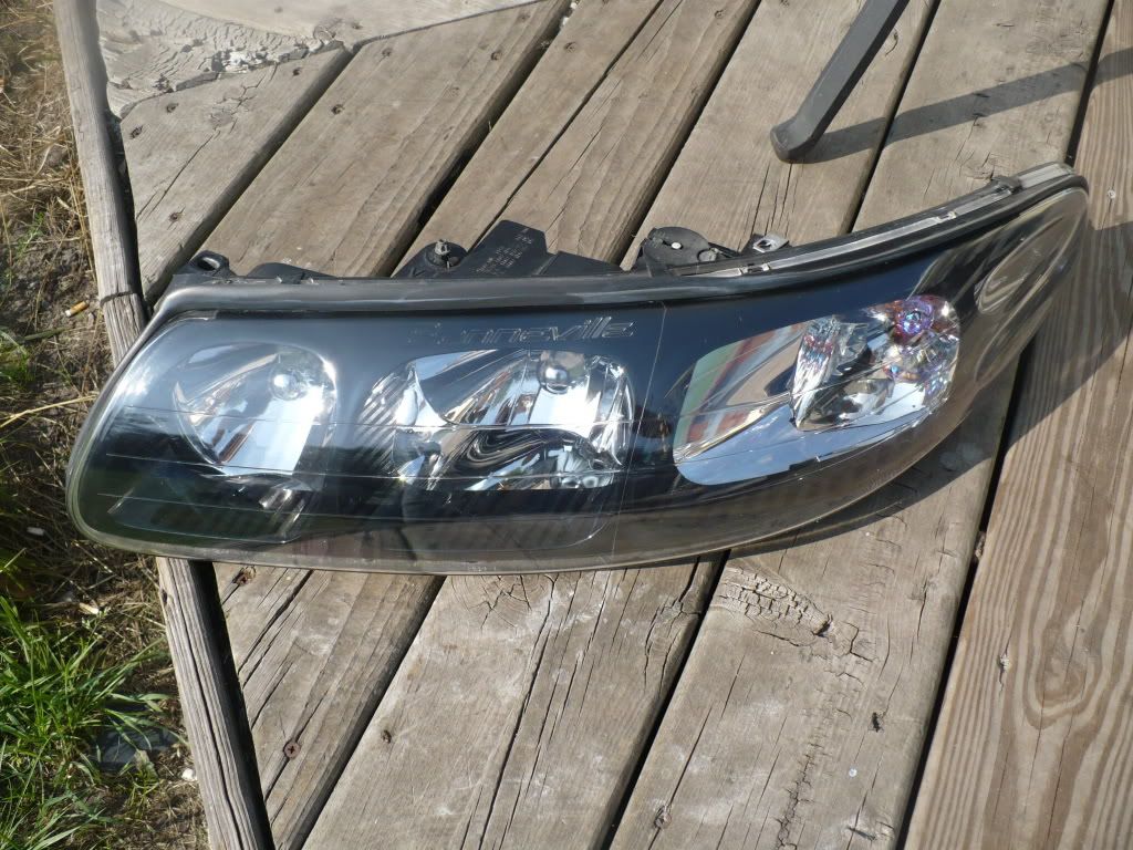

Drivers side, all oxidized and hazed
I pulled the headlight and wet sanded with 400, 1000, 1500, then 2000. After wet sanding, it was polished with Menzerna polishes.
After complete wetsanding
Here is the tools for the next step
After one hit with the Menzerna Power Gloss Compound
Second pass with PGC
After polishing with Menzerna Super Intensive Polish
Final polishing step, Menzerna Micro Polish
On the car
Before
After
Couple more shots :banana:
