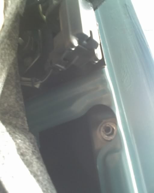

:helpsmilie: Hey guys, Mark here. Need to replace one of the marker lights on the trunk. How do I get at it? Do I remove light section from the trunk? If so, where are the bolts located. Thanks. :banana:

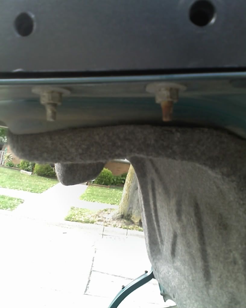

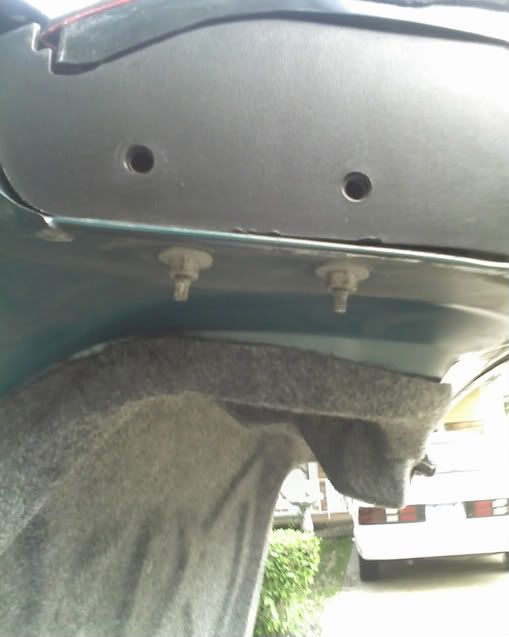

when you open the trunk there are 5 10mm nuts, 2 on each side and one that is hidden under the liner of the trunk lid.
the holes you see are for plastic pins that probably release with a flathead screwdriver, for some reason those were lost before i owned the car, they might need to be loosened before it will come off
and then this one is to the right of the trunk latch
after those come off the casing should come off and the bulbs are right there.
