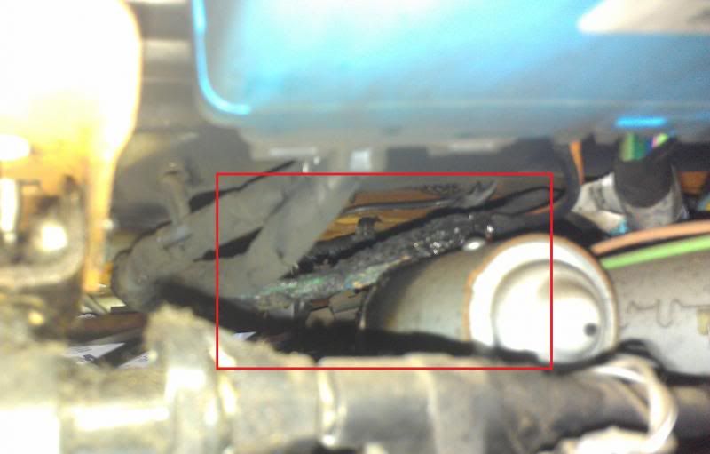

I got your PM about the wiring harness. Can you post a picture so I have an idea of how bad it is?

Location: WNY
This is the best picture I could get crouched down in my employers parking lot. As you can see, the harness is all melty. That's the area the fire was confined to. I don't know yet if the motor was damaged (see the black?), but I'll cross that bridge when I get to it.
Hope that helps you out- this is looking from the front, toward the back. Specifically, I held my phone towards the middle of the car, and angled it towards the drivers side looking back.

Ok, bad... but definately fixable. I'll PM you about the harness.
