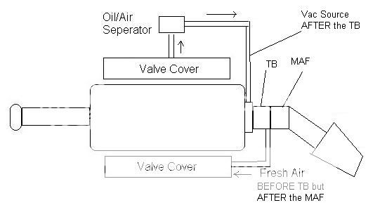

You need to make a functional pcv system, breathers are for junk builds; run a catch can setup. Cap off the nipple on the backside of the gen v (the fresh air side of factory pcv) run a line from N* to fc, on rear vc add a pcv valve and catch can run line back into a vacuum source after tb blade. (Mine just runs factory pcv valve in stock location).
