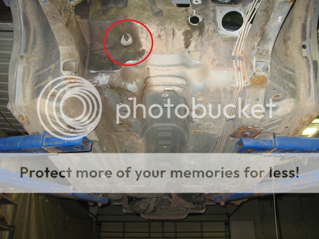

Something similar happened shortly after I purchased my 2000 SE last year - I heard water moving in the HVAC system while turning. I found the evaporator drain off a site for the Grand Prix but ours is basically in the same place. From under the car follow the exhaust down along the firewall - the evap tube is on the passenger side - you may have to move the heat shielding out of the way. I used a section of weed whip line to free the clog - I could not believe how much was in there! So far have been lucky as fan still operates as normal.

Here are some pics of the evap drain location: post372705.html
