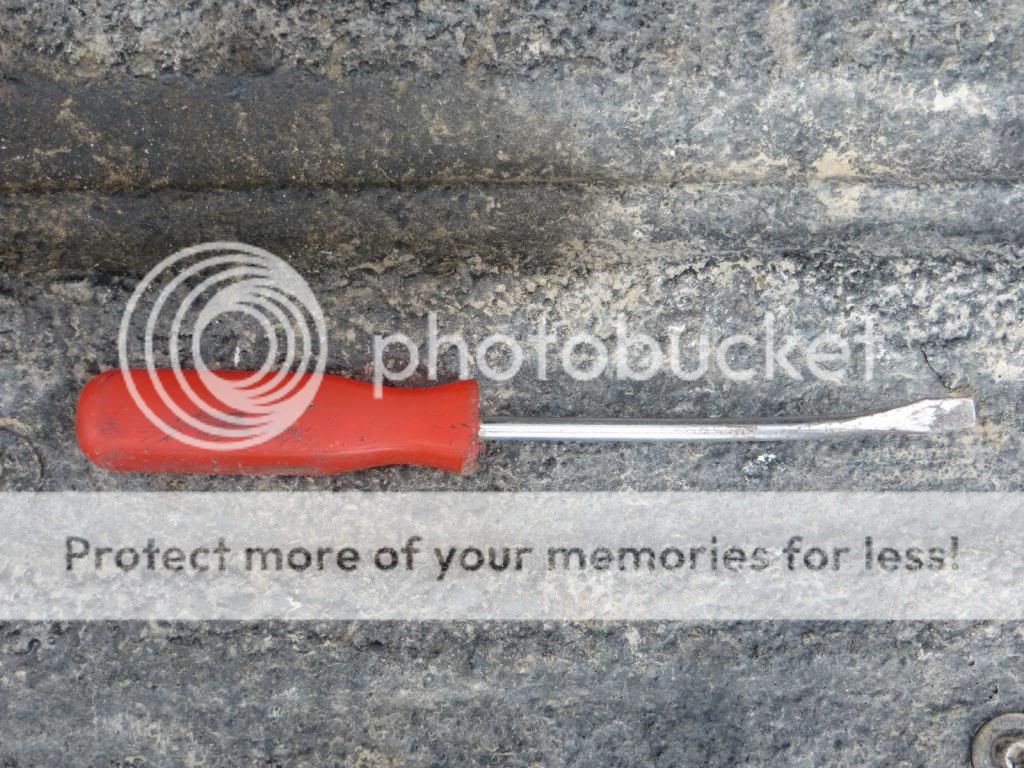

I just use a bent screwdriver to release the airbag. I usually don't remove the airbag to swap buttons though.

I didn't have to either. Just a very thin screwdriver to use to pry the switches out of the wheel, and be careful not to pull too hard on the harness. Those wires are thin.
