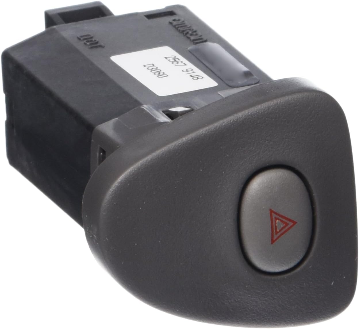

The flasher relay module looks like this:
https://www.amazon.com/dp/B004JBCK4K
Standard also makes one, but appear to be out of stock everywhere: part number: HZS187
However, I do sell good used ones. I have boxes of them. PM or email me andrew.suderman@gmail.com

Thanks for the reply. I know where that switch is, and how to remove it, but is the 3 prong flasher (pictured below) inside/behind that actual switch button?
https://www.amazon.com/gp/product/B0013FHCDE
When I hear the turn signal/hazard (fast) clicking, it seems to be coming from just behind the switch button. I don't want to try to crack open that switch without knowing that the flasher is inside...

PostPosted: Thu Dec 23, 2021 12:42 pm
Here are some pics inside the flasher relay module. If you have a flasher that is flashing faster than normal it just means you have a bad bulb or LED's without resistors. Every time that I have seen a flash module die, they don't produce any flashers nor turn signals.

The switch/flasher module above is the solution to the hyper-flash or frozen flash problem. (check all 4 bulbs first if you have this problem)
