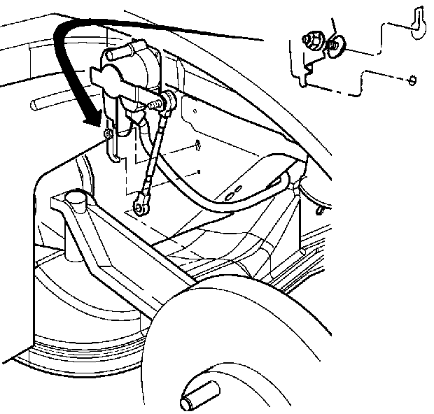

Could you please tell me if there is a write up somewhere on how to replace the ELC sensor on my 00 SE, and if not, could you tell me what I need to do in order to change it. thanks

Automatic Level Control Sensor Replacement
Removal Procedure
Raise the vehicle. Refer to Lifting and Jacking the Vehicle .
Remove the wheel from the vehicle. Refer to Tire and Wheel Removal and Installation .
Disconnect the height sensor connector.
Disconnect the sensor link from the ball stud.
Loosen the sensor mounting nut.
Disengage the anti-rotation tab and slide the sensor downward.
Remove the sensor from the vehicle.
Installation Procedure
Insert the head of the sensor mounting stud into the key hole.
Slide the sensor upward until the anti-rotation tab engages in the lower hole.
Tighten the sensor mounting nut. Tighten
Tighten the nut to 9 N·m (80 lb in).
Connect the sensor link on the ball stud.
Connect the height sensor connector.
Install the wheel on the vehicle. Refer to Tire and Wheel Removal and Installation .
Lower the vehicle. Refer to Lifting and Jacking the Vehicle .

would a bad sensor cause the back end of the car to jack way up? but the compressor to shut off after about 5 minutes

Yes, this is possible. Sounds like the sensor beleives more has to be done to level the car and the pump simply keeps running. My buddy who had a 92 SSE had this problem.
Keep in mind however that it may have had a lot of pressure to RE-build-up. 5 mins sounds like an aweful long time though. Are you sure it's TOO jacked up? Or might it just look that way compared to the lower position you got used to?
I replaced my sensor two weeks ago because the linkage and faceplate of the sensor broke off and I was experiencing the opposite issue you are experiencing. The pump never engaged beyond the start-up check which should last only about 5-10 seconds. I actually had to readjust the pitch of my driver seat after the fix! lol
Do you have the linkage installed as per the diagram?
