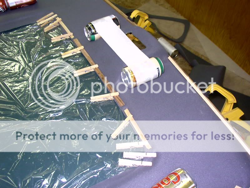

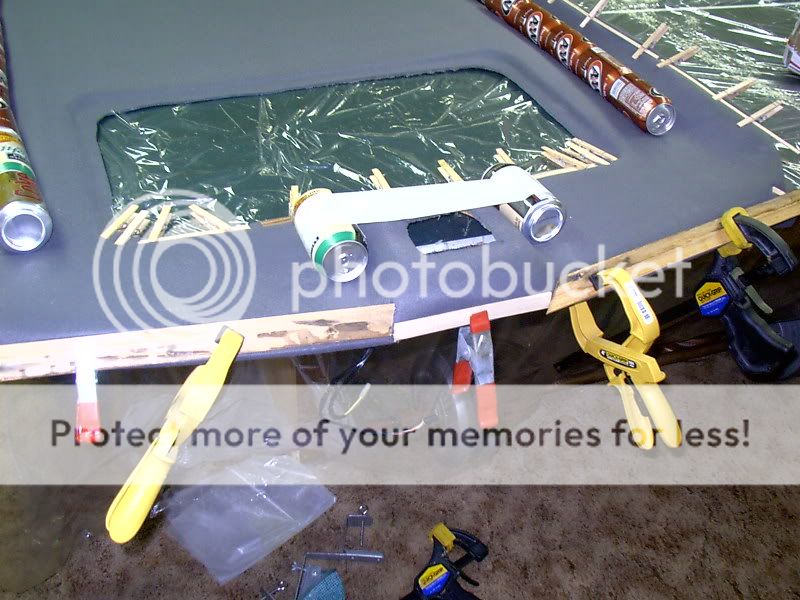

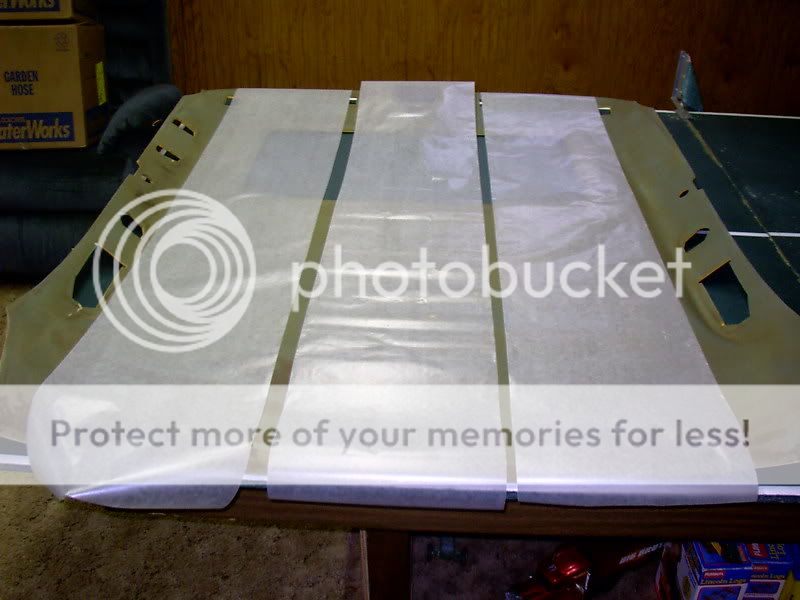

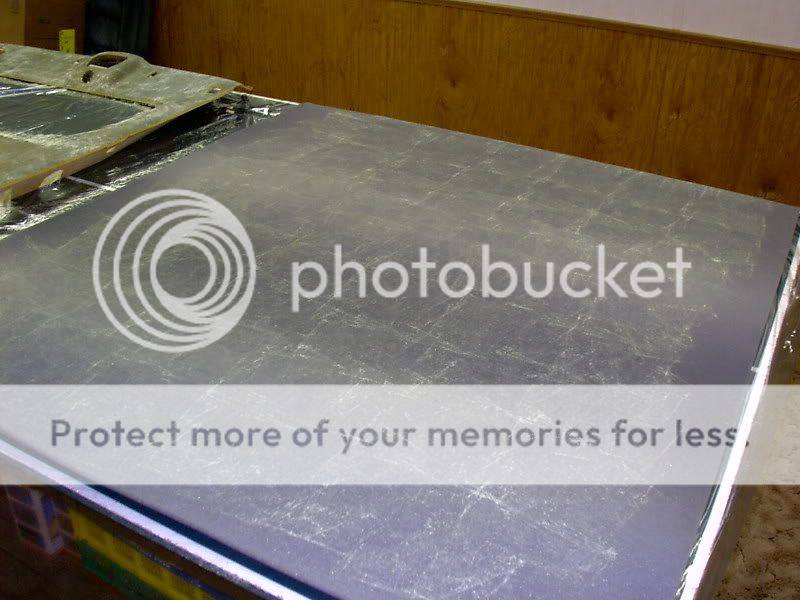

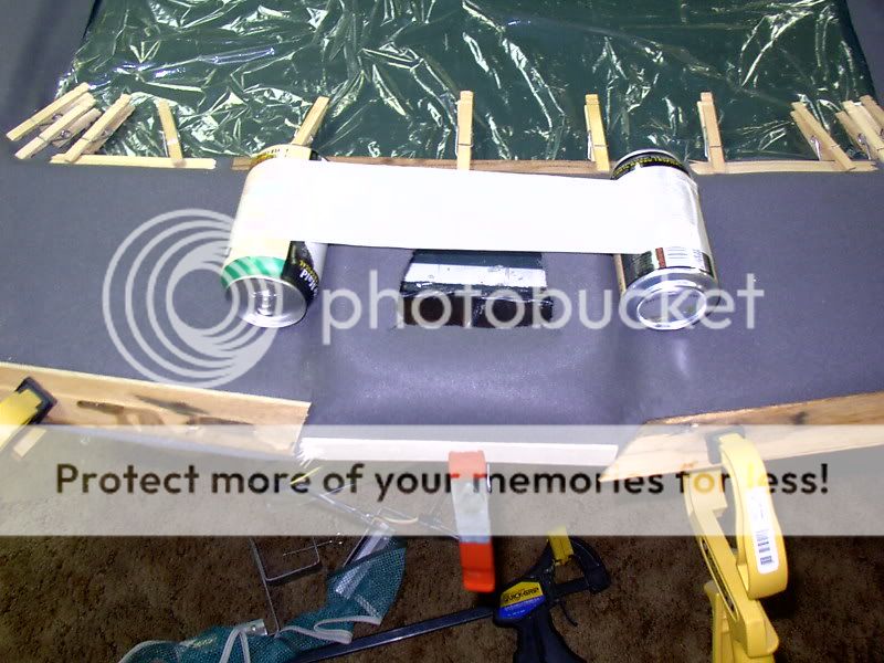

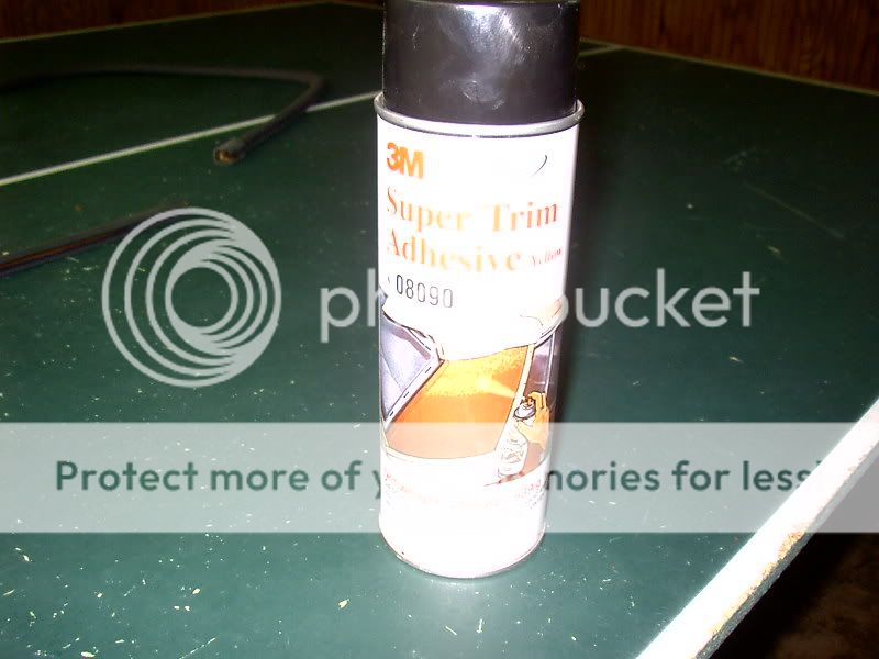

harofreak00 wrote:well i finally got around to doing this because i dont work today. i bought the 3M super trim adhesive (#08090) from my local parts store and got the christian discount on it, i paid $15 this stuff is made for heavyweight headliners, dont use the general trim adhesive (#08080). i had my dad help me lift it on there, but otherwise i did everything else. i had taken this headliner out about a month ago, and it had just been sitting in the basement. i bought the fabric from hancock fabrics for $8.99 a yard, i got 2 yards, so that gives me about a foot of extra. i sprayed 3 coats of glue on the board and on the fabric, let it dry for 5 min. i layed down 3 sheets of wax paper, but i ended up not needing it, this stuff only sticks to itself. and then i placed it on. at first i got really pissed cuz it wasnt sticking, but i guess it just takes time. you really have to work with it. anyhow, heres the pics so far...ill prolly put it back up tomorrow.
