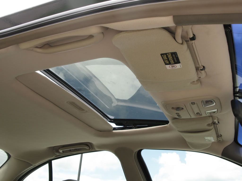

harofreak00 wrote:As you may know, I already have 1 tutorial in this section for a headliner replacement, but that was for my 95, and that was almost 4 years ago now. I have more knowledge, and I wanted to tackle this on my 2000 SSEi. The previous owners smoked in the car, and the headliner was full of cigarette burns. Since I have redone the interior of this car, the headliner is the final ugly piece that needs to be replaced. The sunshade that covers the sunroof when not in use was also starting to fall apart. I had hot-glued it months back, but it was not sticking. Here are some pics of the damage.

Now, let the fun begin. Start by removing the sunshade from the sunroof track. There are 4 tabs that hold it in. Open the sunroof all the way back, and then push in on the tabs with a screwdriver or something and lift the shade up.

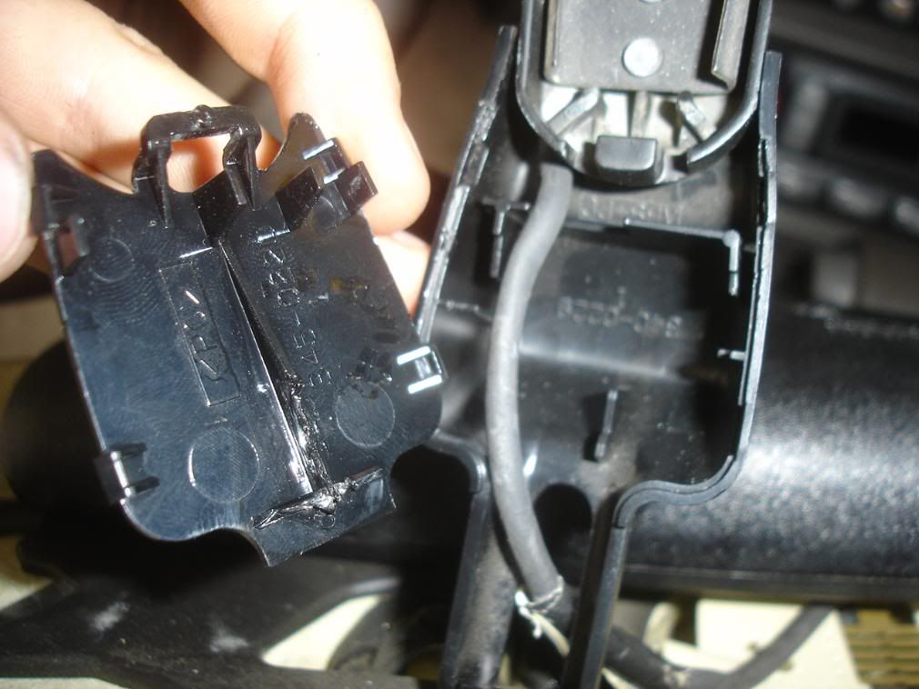

Once you have the sunshade out of the car, remove the handle plastic with a flatblade screwdriver. Then set the sunshade aside for now.

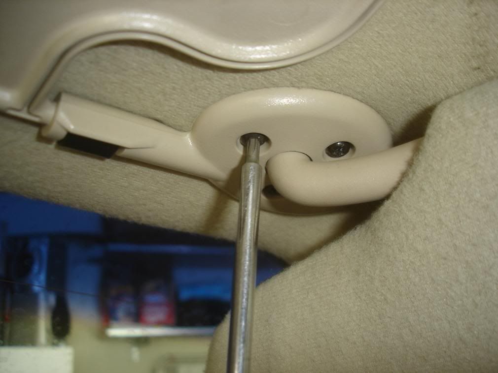

Grab Handles - passenger front, and both rears - Make sure you put the screws somewhere that you don't lose them!

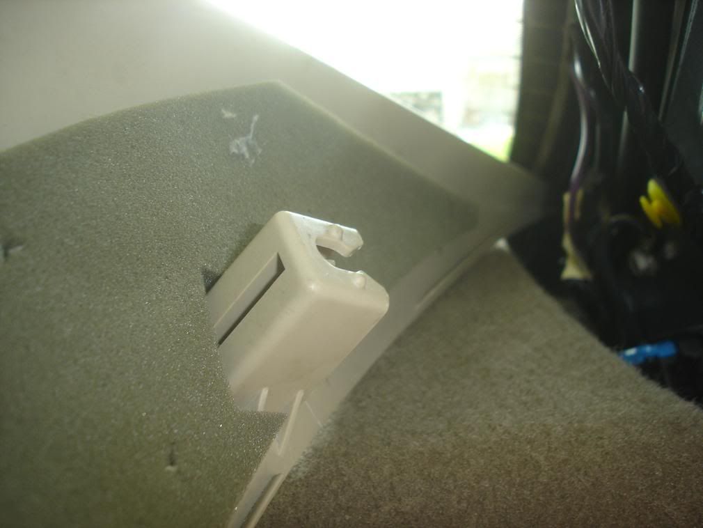

Start removing the fabric. Don't worry that the foam is sticking to the board and not coming off with the fabric. If this happens, it just means the foam is in good shape. However, you do NEED to remove the foam in order to get the new fabric to adhere.
You should end up with something like this. Now start to remove the foam. I learned this tip from my guy Kevin at AutoHeadliner.us Use a wirebrush, not sandpaper like I used on my last headliner. I used a small handheld one for the tight areas and a wire wheel on a drill for the larger areas. You do need to be careful not to damage the fiberglass board, but the wirewheel did the job perfectly.
This leaves quite a mess, so be sure you can do it somewhere that cleans easily.
After you get ALL the foam off, go over the entire thing with some thinner and some compressed air you have access. You might find some more foam during this process, don't be afraid to go back a step and remove ALL the foam. Here is some up close of the fiberglass with the foam removed.

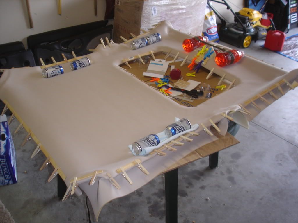

Since I was doing this by myself, I couldn't get any pictures of the next step. It consisted of picking up the fabric and folding it in half, adhesive side out, and then applying to the middle of the board and then laying flat and spreading out. I would highly suggest using a 2nd person. I think it would have went much better with another person. The adhesive isn't immediately bonded, you can still adjust the fabric for a few minutes. After working it down into all the corners and edges, use small pieces of thin strips of wood, tons of clothespins (I bought 100 and used them all), clamps, and beverage containers. This is a very time critical point, the fabric needs ot be pushed down into EVERY crevice or it won't ever stick.
After several hours of drying, the fabric is stuck good enough to remove the clamps. You don't want to leave them on forever, or you will have permanent indents in the fabric.
