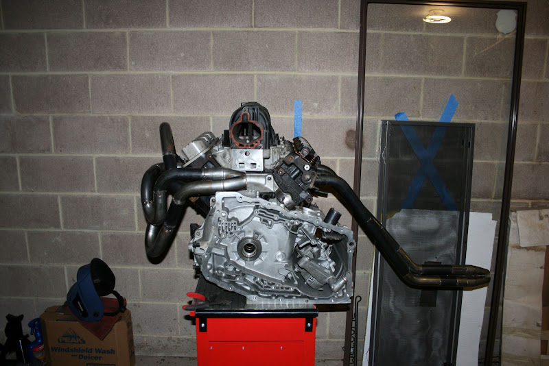

Will you be running EGR? Those headers look mean as hell! (They would look real good under the hood of a certain SSE

Lol.
Nah, no EGR. I'm going to replumb the pcv through an oil/water separator at first too. Then, I'll hook up my vac-pump setup again.

Ooh, custom LTs. Are you expecting much advantage over available SII headers or is this one of those "because I can" mods?

I can't expect huge gains being an n/a v6. But, I'm sure there will be gains.
Quick and dirty of why:
Angled primaries matching the angle of the exhaust port (vs. making the common nasty transition into the primary)
33" long primaries (I calculated the optimum length a few different ways)
True merge collectors (vs. the nasty group together and weld sheet metal around aftermarket collector)
