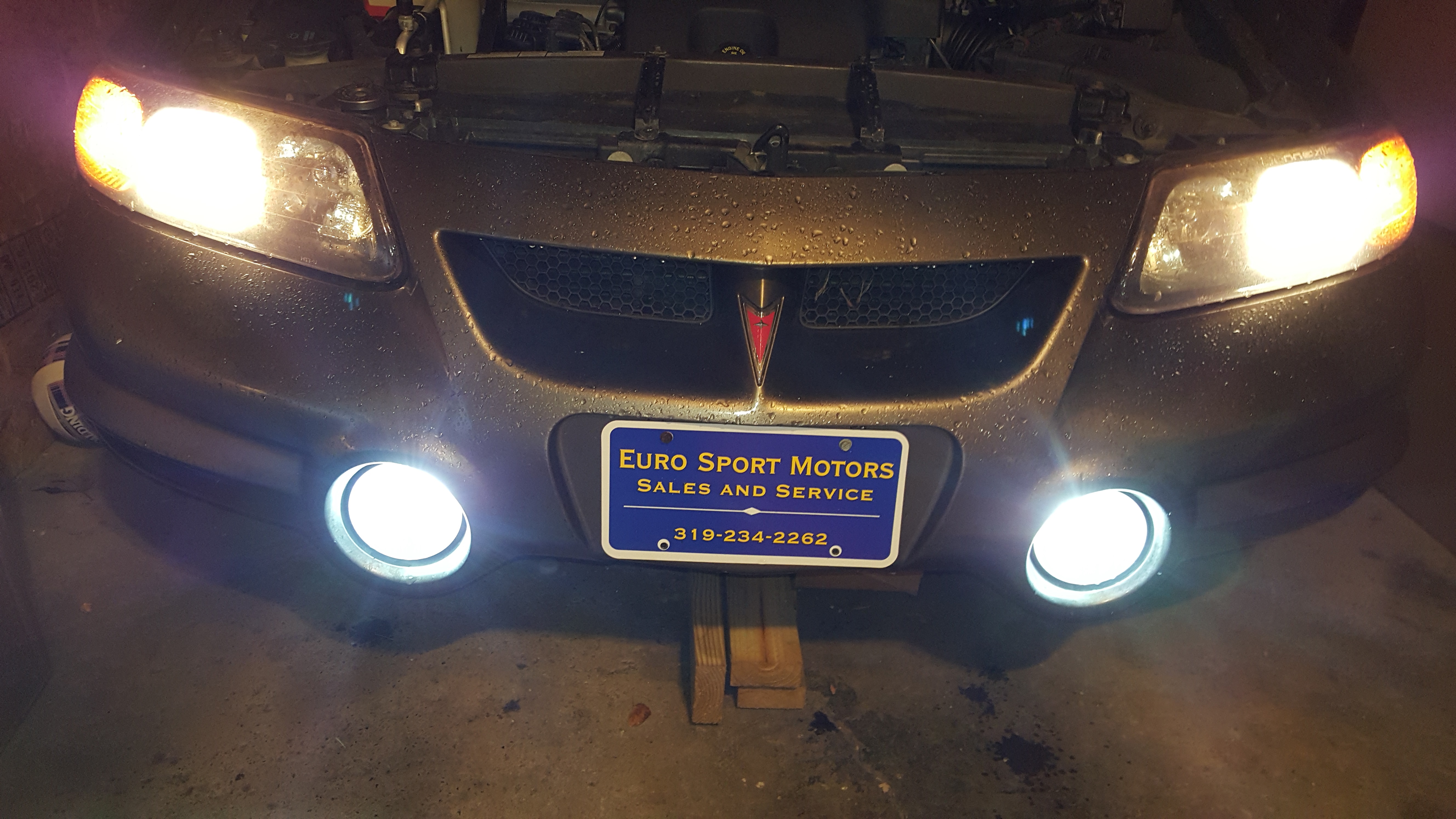

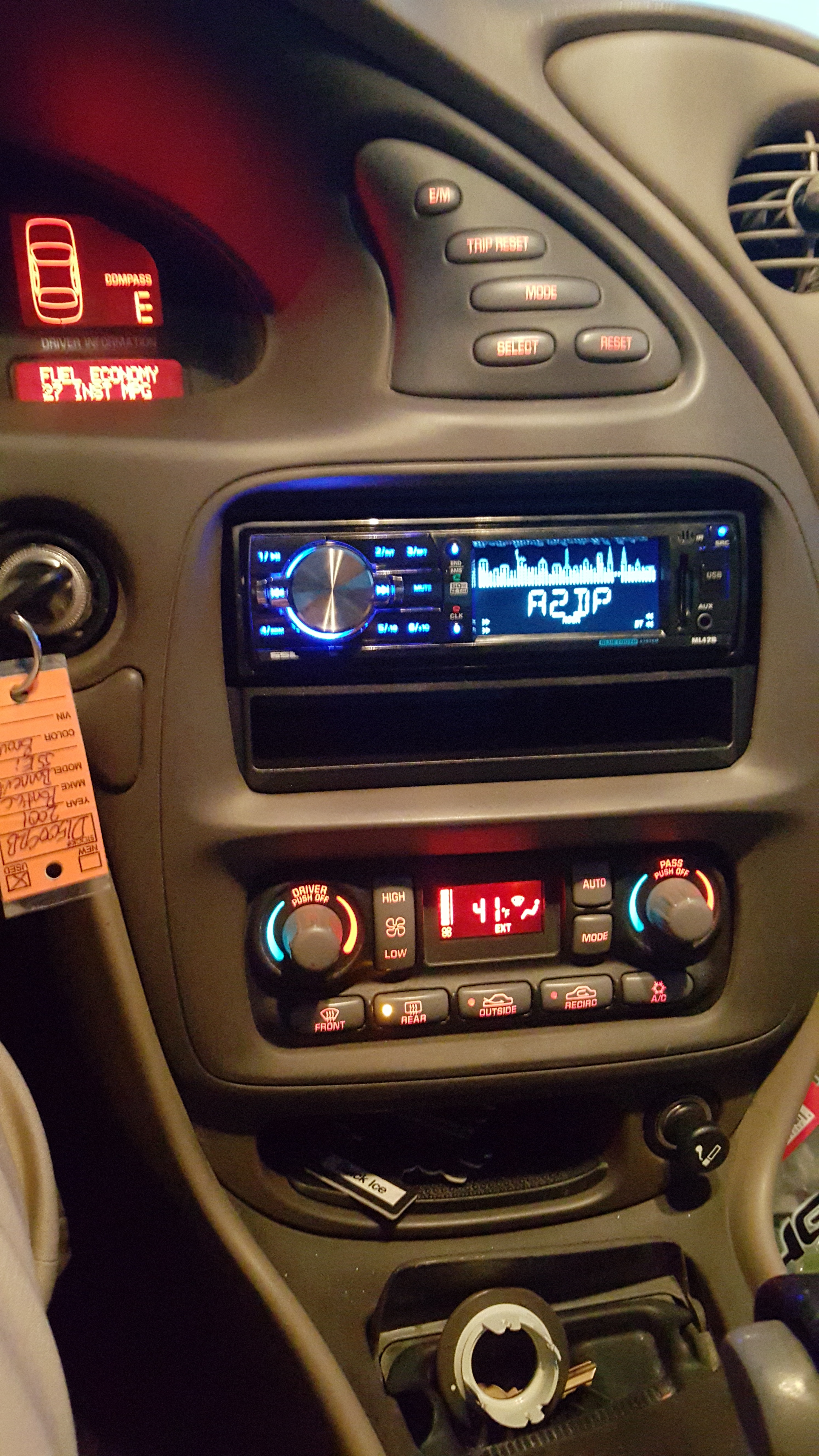

I was able to install the LED fog lights and stereo over the weekend. I still need to mess with the mounting of the stereo bracket. I read someone was able to reuse the stock radio clips so I'll have to try that.

bigchieftaco90 wrote:I was able to install the LED fog lights and stereo over the weekend. I still need to mess with the mounting of the stereo bracket. I read someone was able to reuse the stock radio clips so I'll have to try that.
What brand of fog lights did you use? I like them!bigchieftaco90 wrote:I was able to install the LED fog lights and stereo over the weekend. I still need to mess with the mounting of the stereo bracket. I read someone was able to reuse the stock radio clips so I'll have to try that.

I bought some cheapies from Amazon. I usually go with JDM ASTARs but I didn't want to drop $30 on fog lights.98SSE wrote: What brand of fog lights did you use? I like them!
Here is the exact set I bought. Very similar to the JDMs imo.
Hoping to get a set of Philips 9012 HIR2 soon. Winter = more night driving.

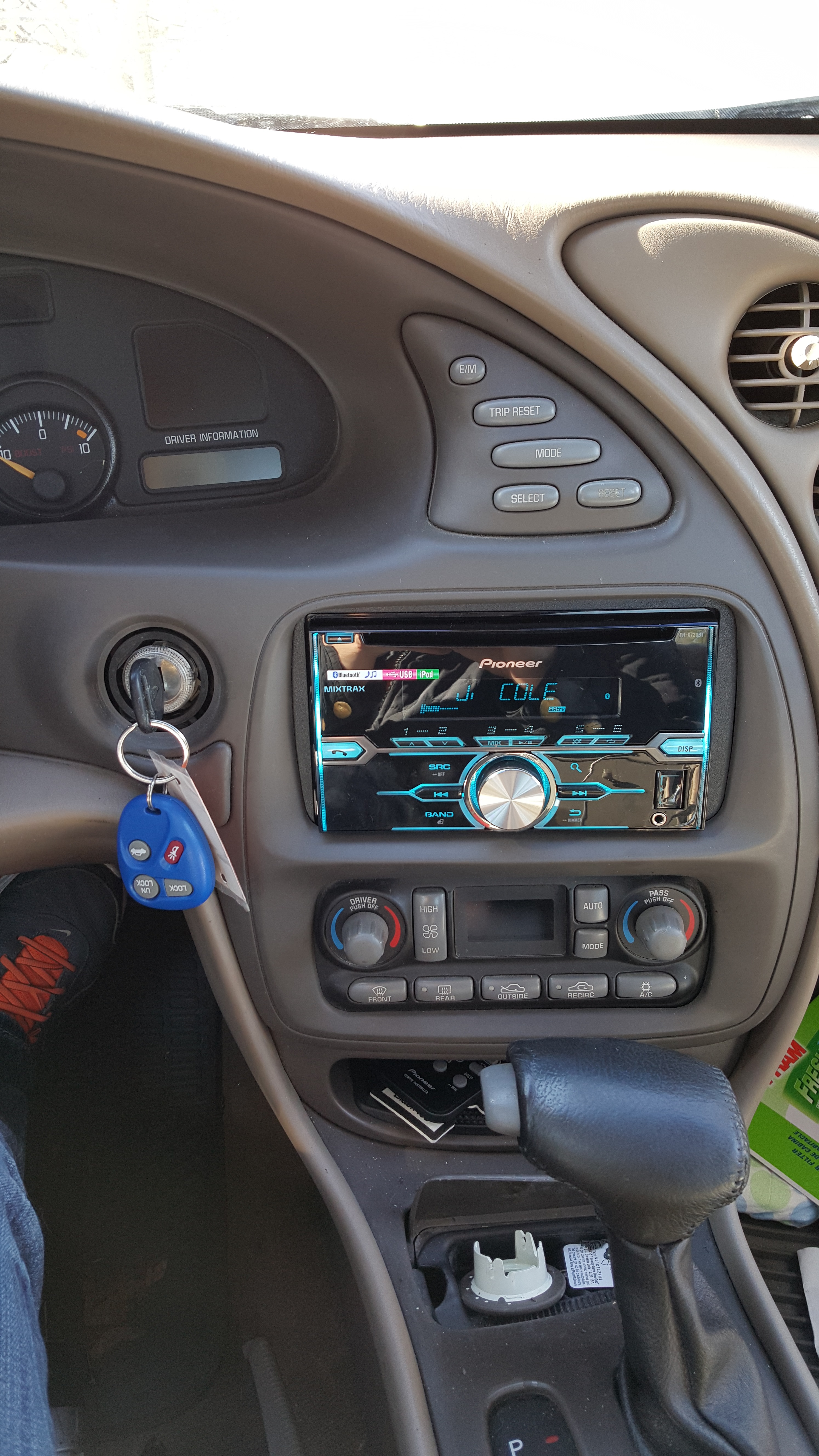

Alright guys. I spent Saturday taking that cheap stereo out and putting in a new Pioneer double din stereo.
I went with the FHX-720BT because I felt like it was the best stereo in the $100 range.
It has some pretty cool features that I didn't know about until I installed.
It has a Pandora Mode. The stereo will automatically start Pandora on my phone and stream via Bluetooth when I start the car. It's a pretty neat feature that I think I will use a lot since Pandora is my main source for music.
Also, I've noticed the car shifts kind of funny. Before I installed the tranny mount I just kind of thought the broken mount might have been the reason but I still notice it.
It feels like a hiccup or something. On my way to work today it seemed like it was shifting very slow. What do you guys think? Transmission going out?
