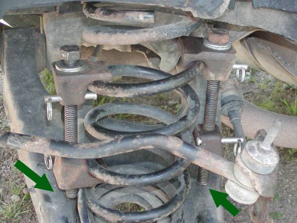

Greetings all. I changed the REAR strut and spring on one side of my 99 Bonneville today. When I searched around the procedure for the spring, they all involved putting the control arm on a tranny jack and taking the arm off. I thought that I knew better, it looked like it would swap out easily if I could pivot the control arm down far enough and maybe get an inch or two out of my spring compressors.
Long story short, I managed to do it, but only by shortening my spring compressor bolts and making a custom unit out of it. The spring is deeply recessed into the control arm, especially toward the center. That made it a tricky deal because the spring compressor bolts would interfere with the control arm.
I was right that I only needed a little compression to get the spring in and out. The old one went pretty easy because it was weak, but the new one was a lot stronger, making it tricky proposition to get those two inches, and handle the spring to get it and the pads all placed properly.
I still have one more side to go ( I ran out of daylight and rain was moving in) and I will do it the hard way since I already made the spring compressor. Knowing what I know now, I would probably take it to a shop for spring replacement next time. I could have been in and out with a lift and trans jack. My way was harder.
