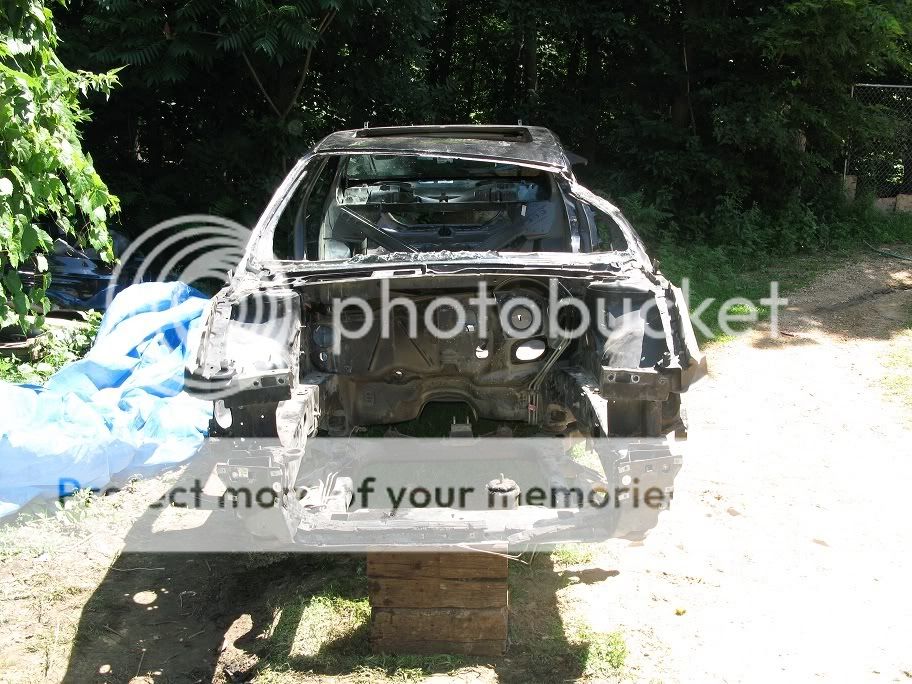

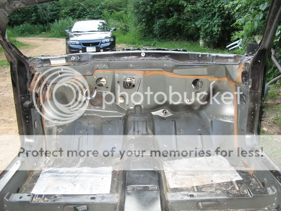

The stock location is on the far passenger side. Its a pretty heavy gauge wire, but not 1/0.
These pics may be of some help
