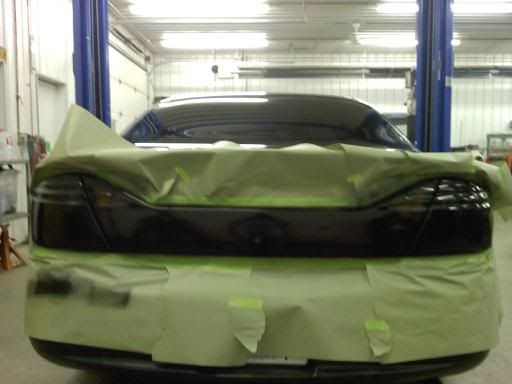

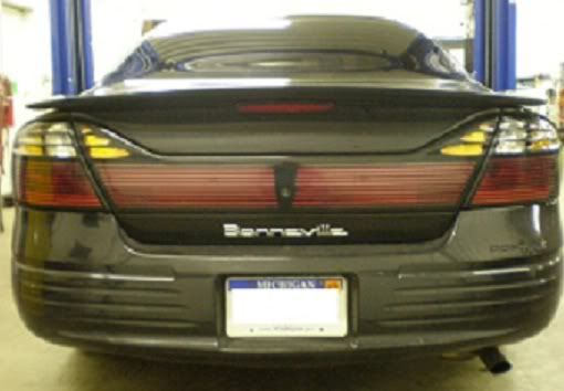

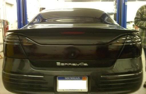

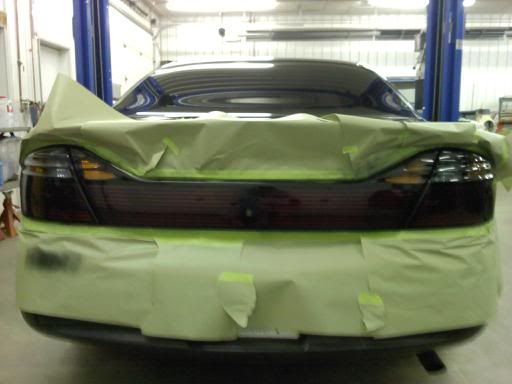

My project last night. Used VHT Night Shades to black out my tailights. Very pleased with the results! I love it.

Put some clear on them now then wetsand and polish them too if you want that little extra pop :wink:

To the OP: those look great! just enough tint to look good, although i agree with Ryan aka Crash, that you should def look into at least putting a layer of clear coat if you havent already ;)

They will oxidize and attract wax that won't buff out if you don't clearcoat them. I strongly suggest removing them from the car for that.
