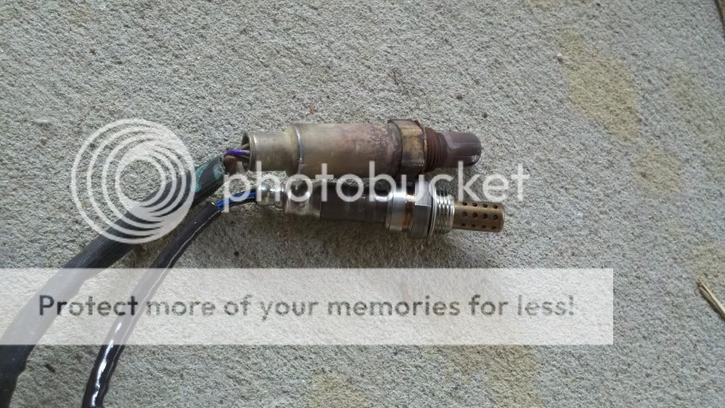

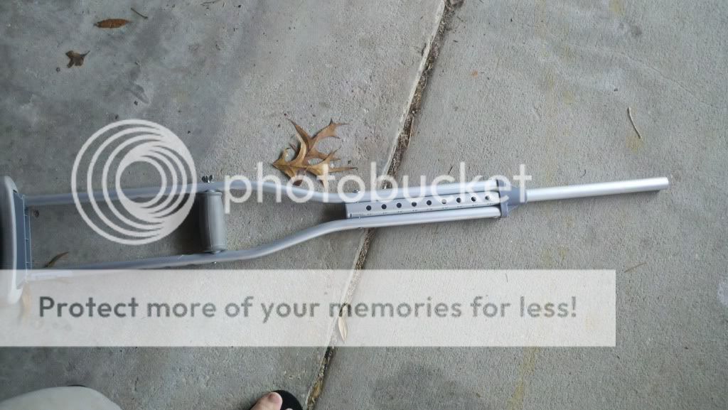

Today I got well enough to tackle the o2 sensor. Went and got the socket like eds and went to town, I had to use an extra special cheater to get it off. Installed new one and presto done! Car seems to run smoother and the butt dyno feels good however I am interested to see if my mileage improves. Btw how tight should I make sure the new one is? I used the 3/8 ratchet and as much torque as I could muster with the confined space and bad angle
New and old
And nobody tell my mom about my extra special cheater from when she hurt her foot :p
