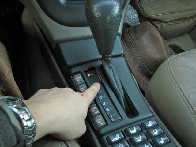

Can anyone detail me on removing the console or this part of it? This indicator panel is loose and I'd like to see how I can secure it back in place.
The loose panel in question.
I'm not sure yet how much of the console I will need to remove in order to get behind that.
It looks like 4 separate parts that fit together.

It's supposed to be that way. Push down, it pops back up.
Problem solved.

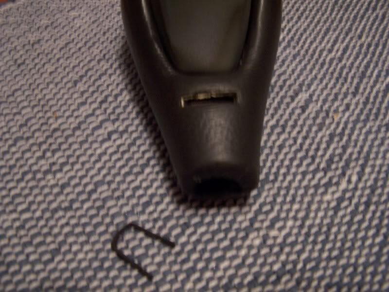

Move shifter to "N" or "D". Underneath the shift handle release button is a slot. Insert small flat scewdriver and pull clip. It looks like a large staple. Pull handle. Lift ashtray cover, remove ashtray, remove 2 screws. Remove console cover.

There's no need to remove the console. The shift bezel is supposed to be pushed in and spring back. There's nothing wrong with it.

There is nothing you can do to change how it sits in there short of major fabrication. Trust those that have removed consoles in the past, and don't waste your time. It works just as it should. Considering the problems you already have with your stereo, I'll caution you that this is a MUCH more serious undertaking, just getting in there.
In addition, nobody since 2002 on this Forum has complained about the fit of that part, and those that know what a bear that console can be would be highly unlikely to pursue any improvements you may or may not come up with.
You'd get more satisfaction out of wiping dirt off your coil springs.

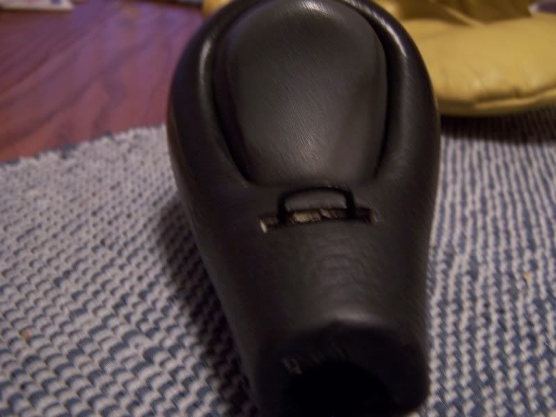

Here is the fitment of the lock pin
Here is what the lock pin looks like

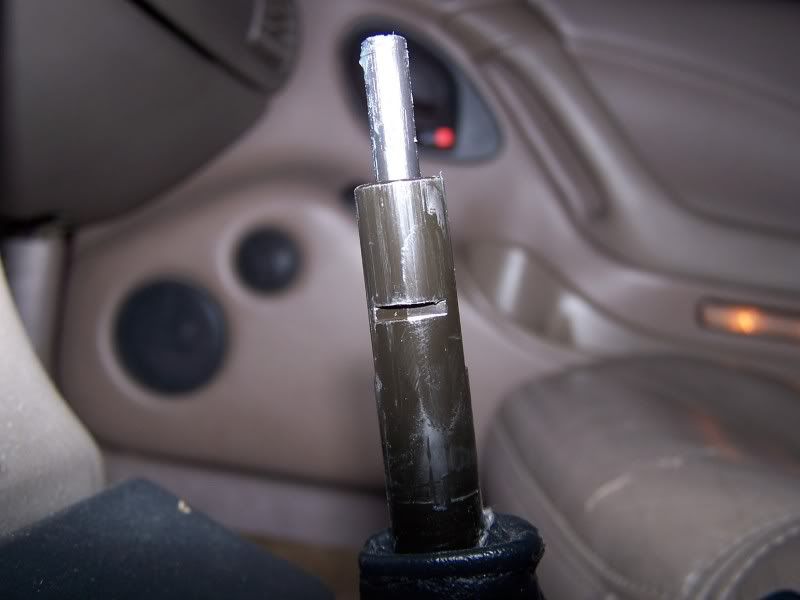

here is the gear selector shaft. you can see the notch the lock pin goes in
as you can see from the shaft, it just slides on and off.

The rounded plastic part closest to the console lid can be pulled straight up without removing anything. You can get a look inside with a mirror to get an idea of what the underside of the indicator looks like. Also makes for a secret hiding compartment :)
