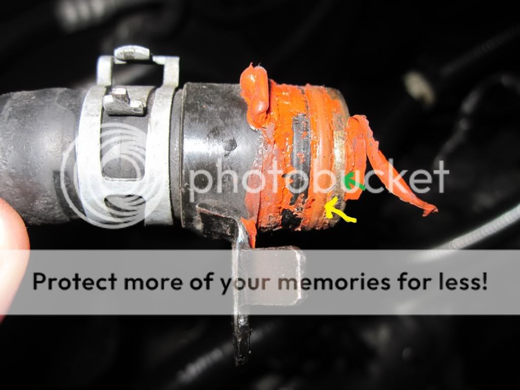

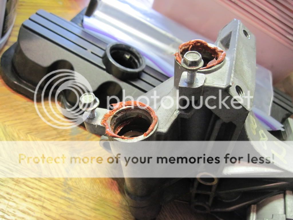

The o-rings will go on the outside of the heater hose fittings. It is best to put some sealant around the fitting before the o-ring so when it is inserted, it pushes the sealant over the o-ring. The hoses are then clamped to the fittings. Fittings are held in by a bolt and they will feel lose when put together.

Here is a picture of the bolts and holes where the fittings go:
Here is a picture of the hose fitting. The yellow arrow points to the o-ring and the green points to the edge where the sealant should be laid (I had extra sealant due to a leak from used o-rings) it does not take much to lubricate and help seal:

Use the RTV. I used gray high-torque RTV sealant on those O-rings and coolant elbows since the first time around I got a nasty coolant leak from the heater hoses a week after putting it back together. It's fixed now, and isn't leaking, AFAIK.
