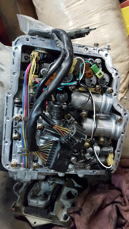

I pulled the trans this weekend and pulled it apart to see if it was a common band or servo issue. Turns out it wasn't.. One of the drums ripped at the top where the clutch pack retention snap ring landing is. There were signs of this metal making it's way through the trans too. Since it's not a simple fix and required purchasing hard parts, I'm going with the used replacement route. I'm going to see what my buddy's can do through their shop contact and go with whatever they find or one of the low-mile options I've found on the interweb.
^^And the culprit. See the teeth up top? That's because that section of the drum is missing.
The basic disassembly wasn't too bad. I put it all back together to use as a core and lining up the clutch packs was more annoying than I remember my 4t60-e being.

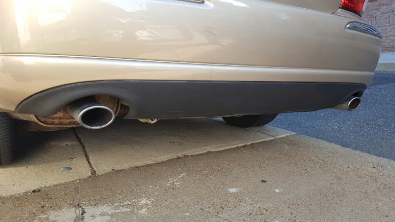

After a few mins the faded rear valance is no more with Mothers Back to Black.
