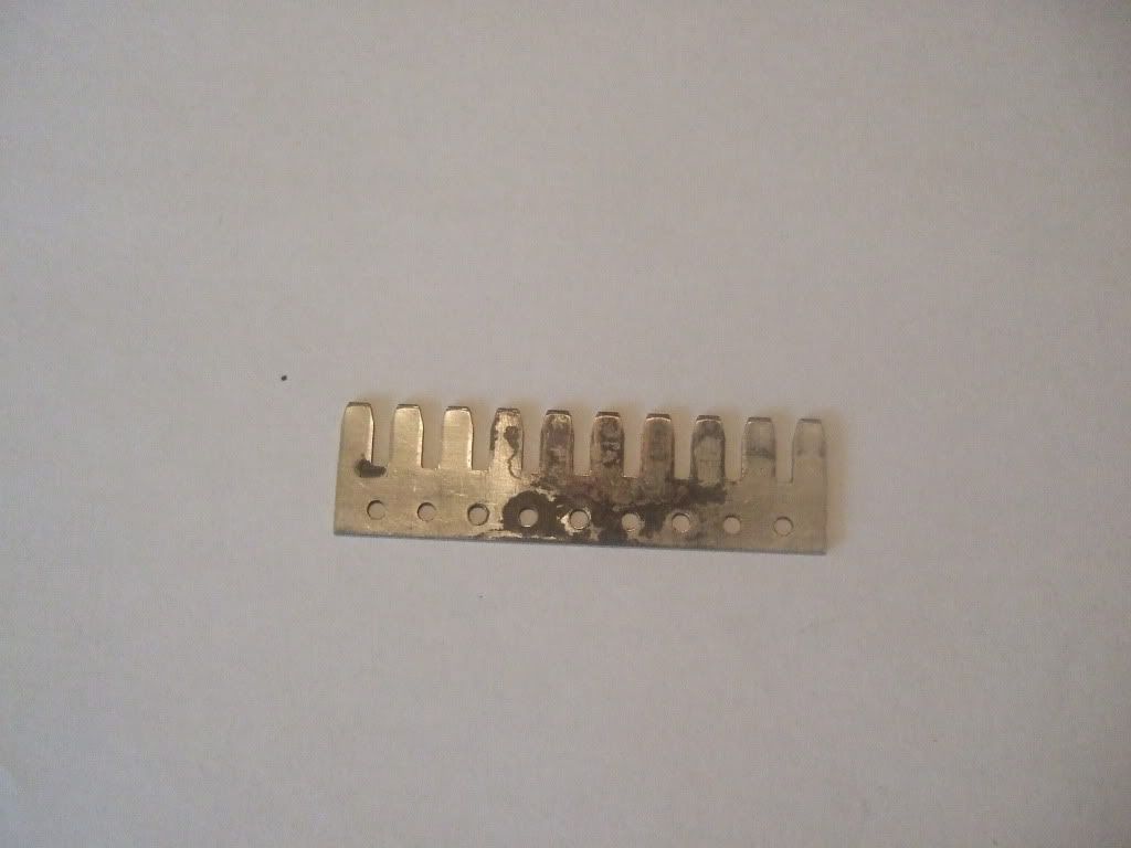

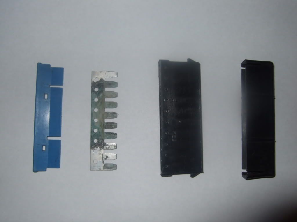

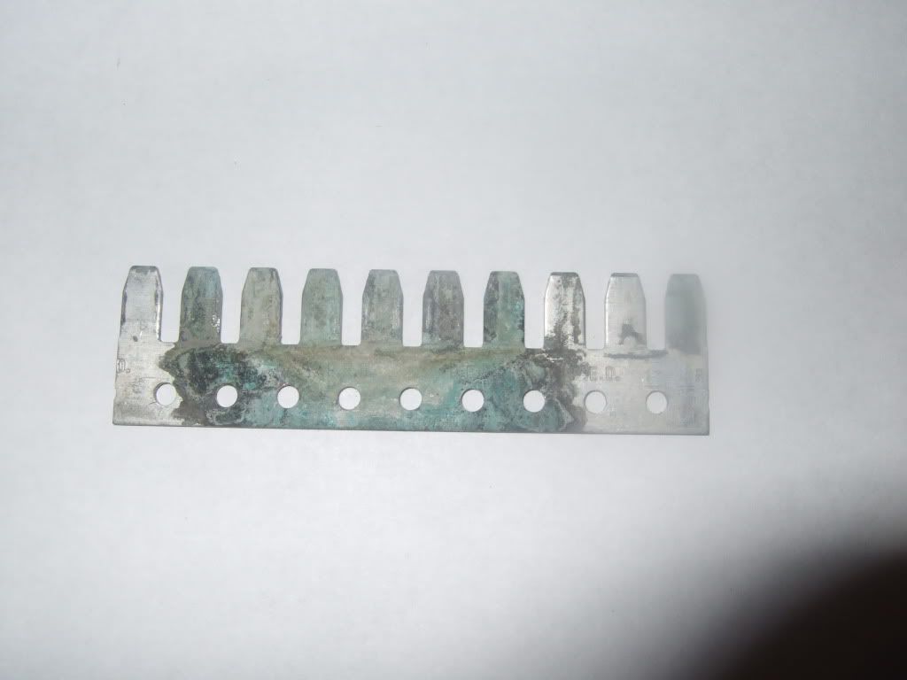

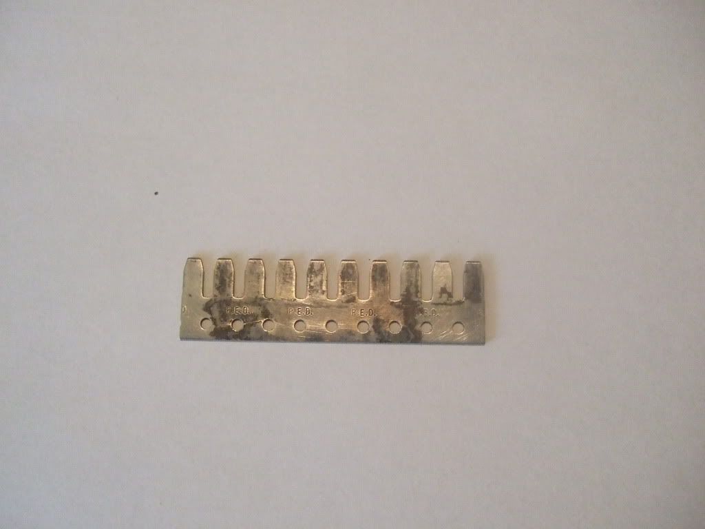

I found the ground bus it doesn't to bad.
PostPosted: Sat May 07, 2011 5:14 pm
Joined: Tue May 20, 2008 4:34 pm
Posts: 3606
Location: Buffalo New York
Year and Trim: 99 SSEi
You need to remove the metal bar from the bus & clean both the male & female terminals. What's with the orange & white wires?

It did remove the terminals and clean the metal bar.
I think the white wire is for an after market alarm system that was installed in the car.
I found the broken orange wire where the white white wire was connected next to the ground bus.
I fixed the broken wire and assembled the cleaned ground bus but the gauges still jump all over?
