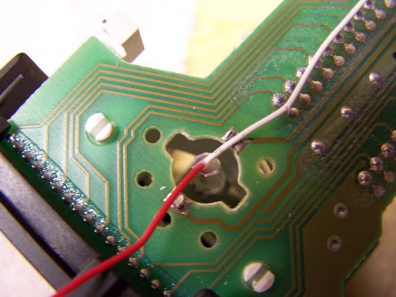

I did this, cheaper

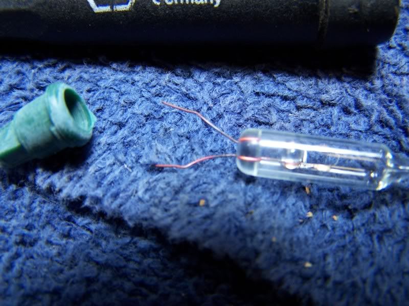

Yeah, I might do it the cheap way, though I'd probably have to wait till Thanksgiving break when I go home to have access to a soldering iron. Did you use all three of those bulbs?
Now its hard to tell from the pictures what you did with the three bulbs but let me know if I got this right...did you use the housing of the original bulb and put these three bulbs in that?

just 1 bulb, actually the bulb on the right package is the one. No, I didnt use the original bulb holder. You could if you busted the old bulb out, drilled small holes for the new bulb leads. Then you wouldn't have to solder, but you would have to solder the bulb in the holder.

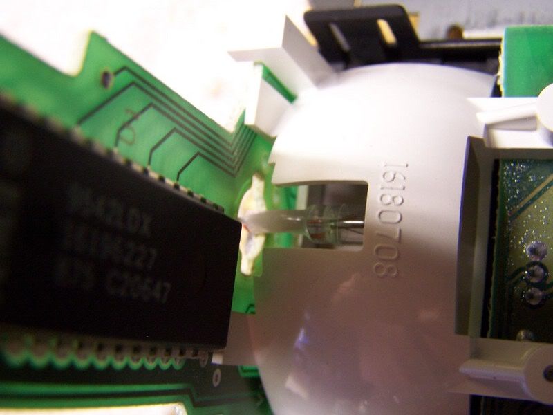

here is what the original bulb looks like
It slips into the hole from the pcb side and twist to make the contacts

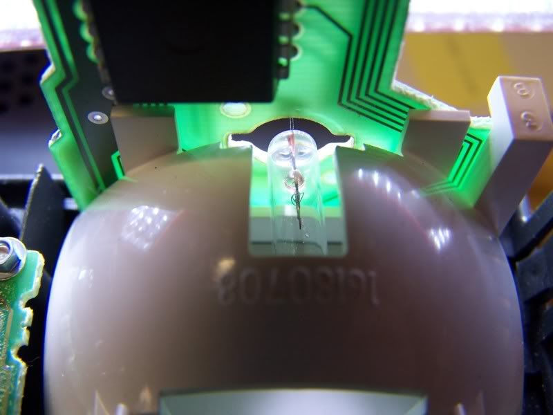

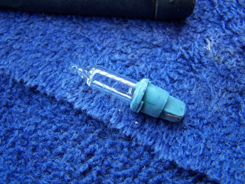

Just dusting this off a little. The bulb finally burned out and I am moving the stereo to the 99 so I had to fix again. Digging for the bulbs I found these
Christmas lights! I decided to give it a shot.
Very bright, we will see how long this last.

Well that only lasted a couple days. Wasn't expecting a lot, since christmas bulb lights are 110V AC. Went down to radio shack to get another of the bulbs on the right, they don't have them anymore. Only the ones on the left. I had those so I stuck in both (in parallel). Works but very dim in night mode, the only time it is a problem is when it is still light out and the lights kick on. My next experiment is with a 194 bulb (glanced at a pkg of them while looking for other alternatives. They will not fit into the hole, the reflector bowl will have to be removed. This will require some pcb removal.
