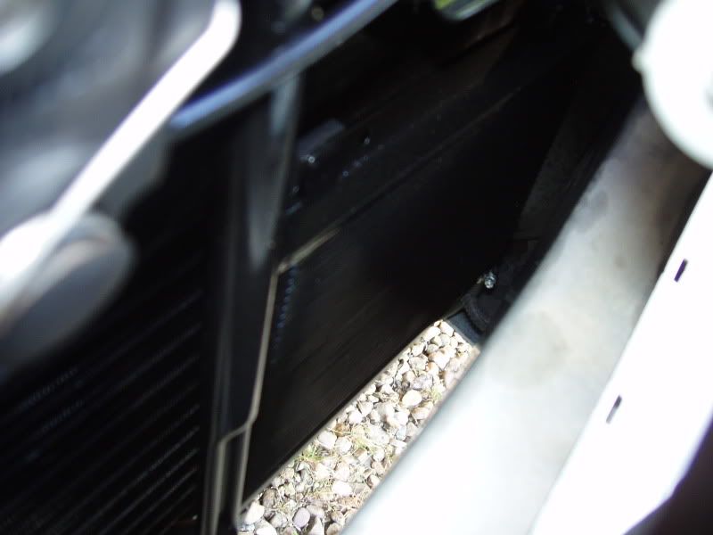

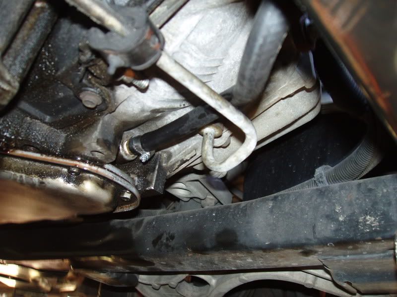

Here's a few pics of mine. The return line going back to the trans:
Looking up from the ground:
And here, looking down right in front of the hood latch:

Thanks for the pics Booze! It appears you have removed your fittings all together, and just replaced with a small hose clamp, seems like a good route to go!
In the second picture, that tube running along the left side, it appears as thats an additional bracket to mount the cooler, was that included in the kit?

The B&M Kit came with everything I needed to get it mounted and extra. That tube you see isn't anything to do with the Trans cooler. It's part of the car. Though off the top of my head I don't remember for what exactly, but probably part of the hood latch structure.
